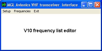

V10 frequency list editor: (Windows, any 32 bit version)
This small program allows you to download and upload frequency lists to and from the V10 transceiver. You can edit these lists and maintain several different lists if you like.
