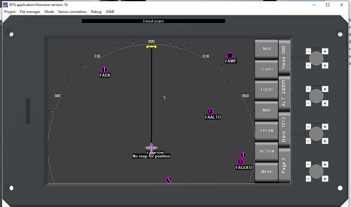

Just for fun, I loaded up a landscape version of the sim. It made no difference to the problems I presented. In the interest of being thorough, I replaced the US navidata with South Africa navidata. I didn't have a map available for the map layer, but I compared what was available to ForeFlight Web and it all looked accurate and the moving map works perfectly.
I set my location to "Morning Star Airport," identifier FAMORN, at S33°45:27 E018°32:58

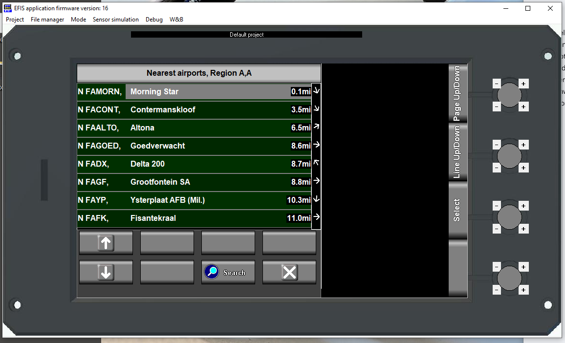

NAV > GPS: Nearest Airports returns this:
Nearest Airports.PNG (104.49 KiB) Viewed 16839 times

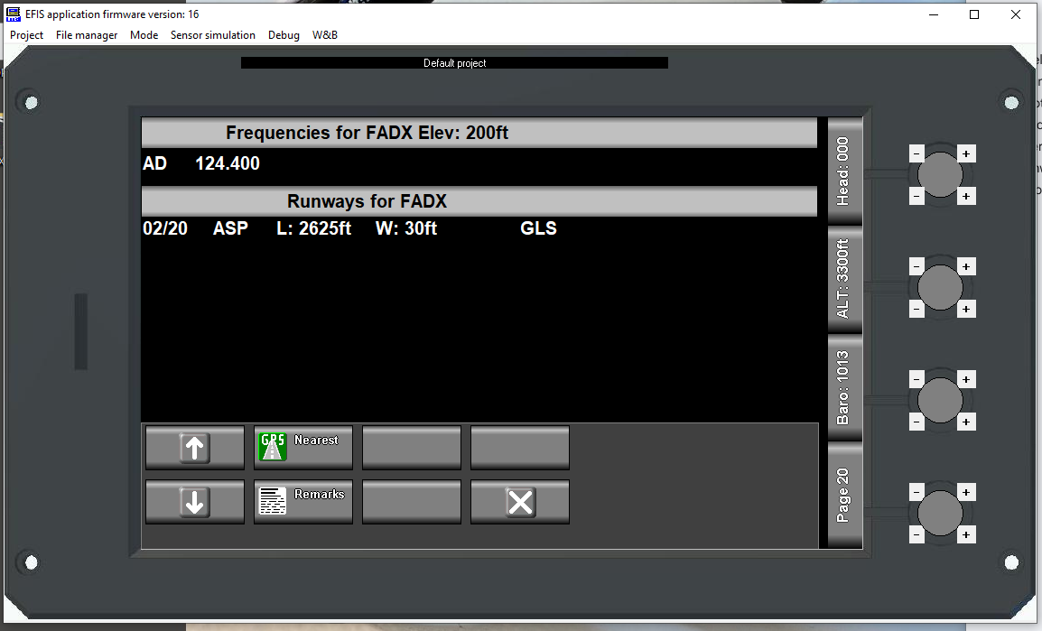

Tapping FADX on the map and then the Airprt softkey returns FADX info:
FADX Info.PNG (91.34 KiB) Viewed 16839 times
So it works as intended in South Africa in the vicinity of Cape Town.
