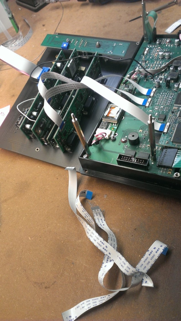

Here is an up date, the ribbon cables arrived from Element 14, a bit slow as they had been on backorder from overseas.
I replaced all the FFC ribbon cables in both my Voyagers. I was anticipating by replacing these ribbon cables in the pilot EFIS, this would solve many of the issues of this EFIS not reading correctly.
Well, after some benching testing, I am jumping for joy, it's looking very promising.
Now on bench testing, the volts are now reading normal, the line on the AOA gauge now moves with airspeed and it has never moved no matter how I calibrated the AOA. The airspeed now reads zero as it should and when bench testing it with a length of hoses and using a "cold" hot air gun blowing flat out, the airspeed does reads about 37 knots on both my Voyagers.
Warning, Don't use any type of compressed air near any pitot tube or airspeed indicator, the gauge will most likely never work again.
Here is a pic
Voyager Ribbon Cable Replacement
Efis Replace Ribbon CablesR3.jpg (199.29 KiB) Viewed 8631 times

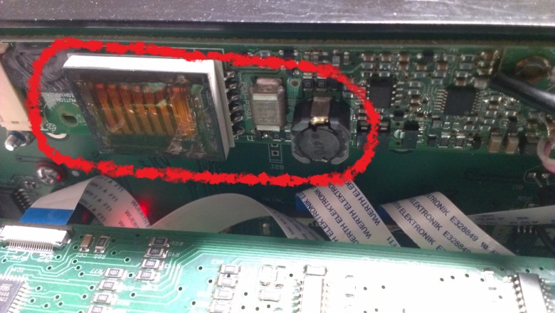

Well, If you have been following this thread and thinking about replacing your flat ribbon cables in your Voyager EFIS here is some important information.
Warning
When you open up any electronic equipment, you should always take notice and even take photographs of where and how any linking or ribbons cables are routed around the place.
There are very good reasons why manufacturers have routed cables in such a way and we should route them in the same manner when replacing them.
I found my ribbon cables routed all over the place and in no particular way with different brands of ribbon cables. So I guess someone has been in there and replaced some of the cables before.
See the parts that are circled in pic, this is the EFIS's high voltage power supply for the screen. Don't let your ribbon cables touch these components. As it's possible the high voltage can arc to and through your flat ribbon cable and burn small holes in and through it.
This may only damage your ribbon cable, but just as easily damage your EFIS beyond the cable and cost much to fix it.
So make sure you route all your ribbon cables away from this high voltage power supply area so the ribbon cables can't touch these components.
