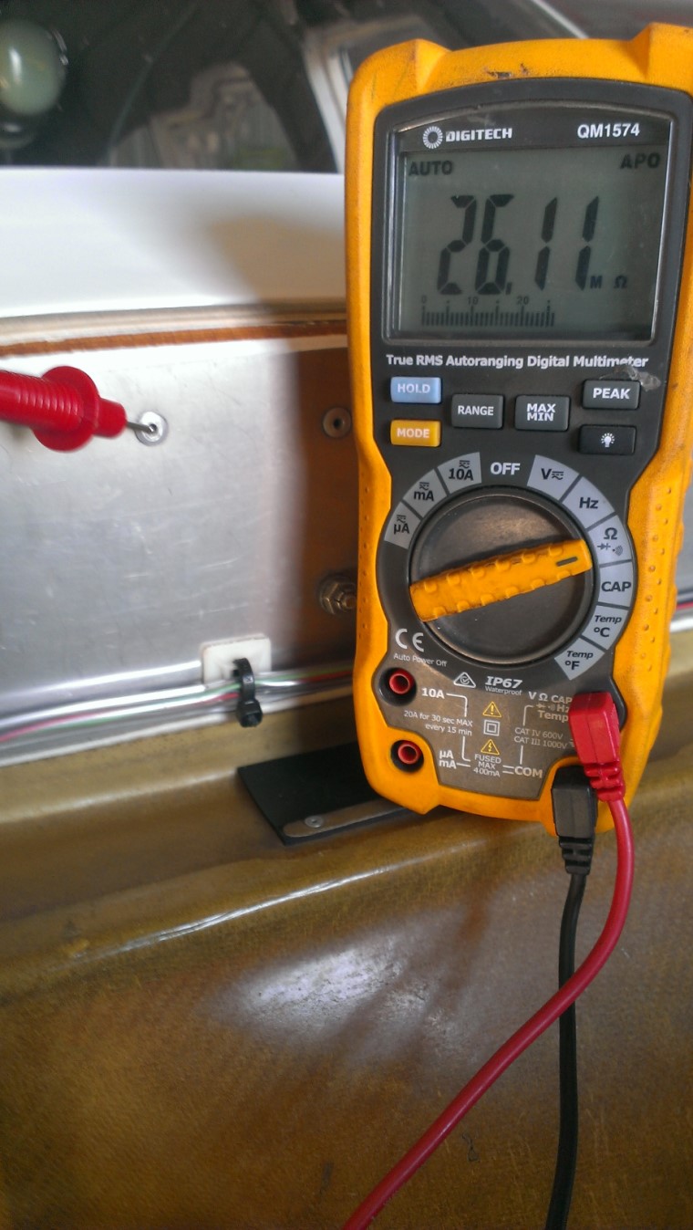

It has taken some time for me to check this out with a multimeter, why I don't know as I spent less than 20 minutes checking out OHMS reading of different parts of my aircraft components earthing back to the engine block to see what and how well things were earthed.

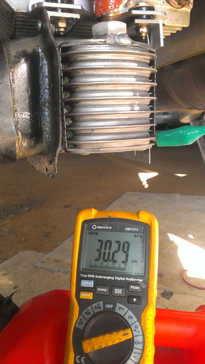

This picture below is of the oil cooler and is of the multimeter OHMS reading back to the engine block. This oil cooler had no earth strap to the engine block and with its rubber mounting is somewhat insulated from the engine block.
So it had a very high OHMS reading to the engine block and of interest, I found the Carby had an earth strap back the the engine block.

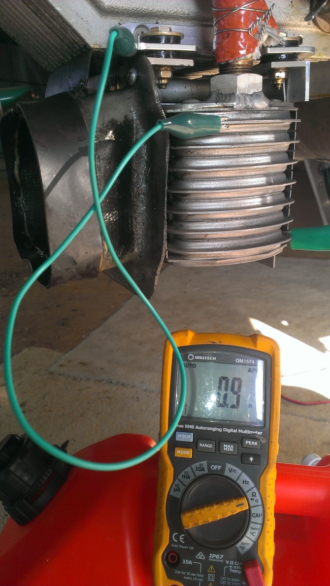

I put a simple bridging test clip from the oil cooler to the engine block, to show how well the oil cooler can be earthed with an earth strap.
So as part of my search to fix my GPS issue, I will make up an oil cooler earth strap to the engine block, like the Carby already has got and see where this leads us.

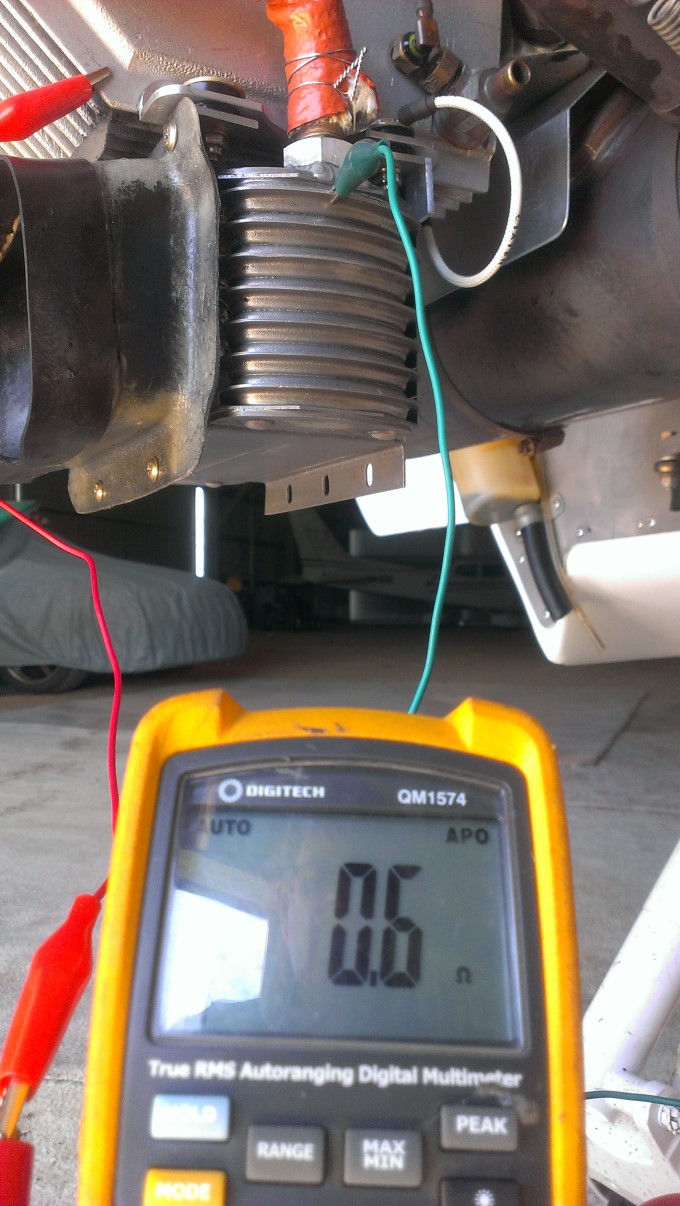

I finally got the type of aviation wire I wanted to use to ground the oil cooler to the engine block. It's the white wirer you see up behind the oil cooler. Looking at the sizes of the wirer loop, I am thinking it could be smaller, but I will leave it for now.
At the moment, I have not taken the plane for a fly to see what affect doing this may have had on my GPS issue. I will report the outcome, but regardless of the outcome, I think it's worth the effort in checking out and knowing how well things are grounded around your plane.
You may find that something is not grounded properly even though it does have a grounding strap, so you could take the strap off and clean the contact surfaces and put the strap back on and find the item is now grounded properly again.
