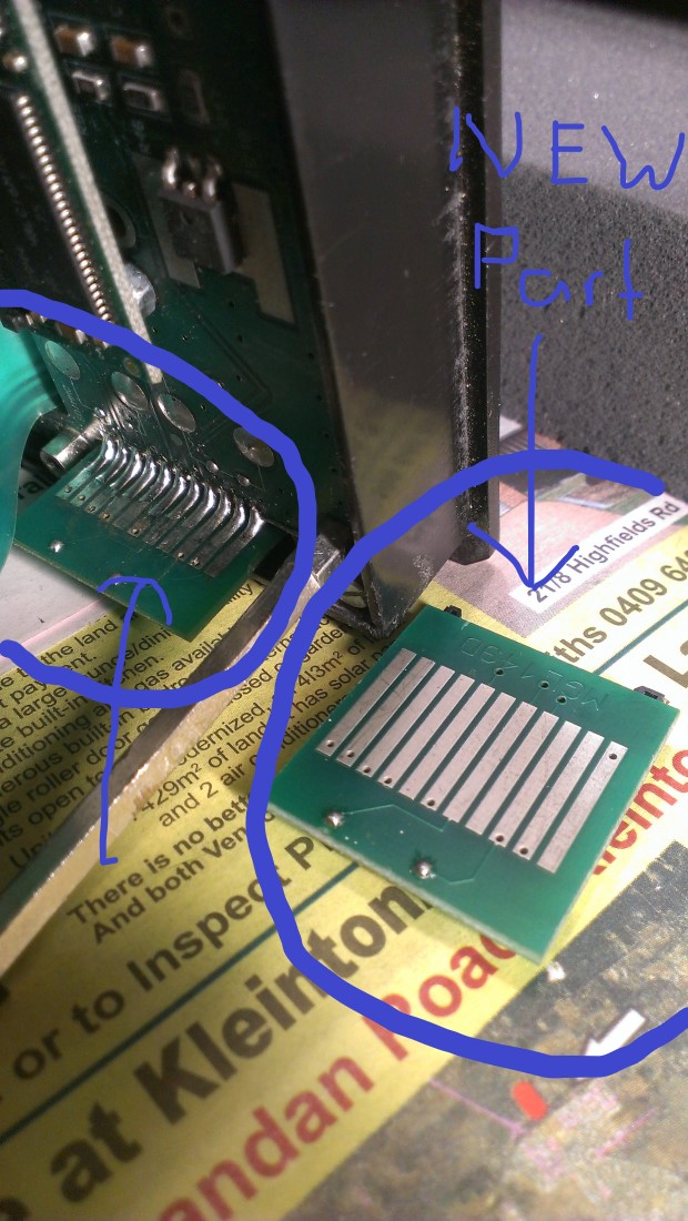

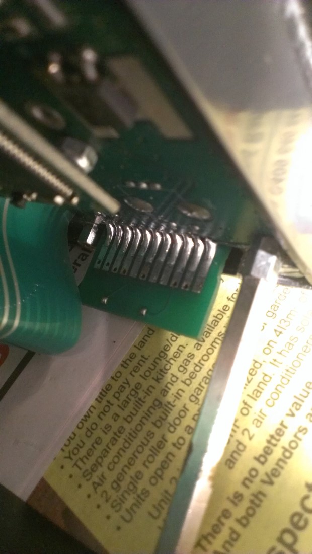

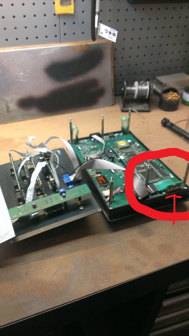

In my situation the back of the SD card module pushed out, so the SD card would push right into the EFIS, so I ended up having to super clue a bit of zip tie to the SD card so I could pull it back out of the module, as it could also still read.
I replaced the SD card module in my Voyager EFIS the other day and I would say anyone who own's their own variable soldering station should have the soldering skills needed to de-solder the SD card module tracks with de-solder braid and re-solder the new card module in place.
But everyone please be "Warned", if you don't have the soldering skills needed, you could very easily over heat or tear off one of those copper tracks and if you do that, you will have a much bigger headache.

This pic shows the position of the SD card Module in the Voyager EFIS.
EFIS opened showing Module
SDCardv2 .jpg (125.81 KiB) Viewed 6972 times
This pic show the module ready to de-solder the track with the new SD Card module comparing it the right part.
Before replacing SD module
SDCardNewOldv2 .jpg (181.33 KiB) Viewed 6972 times
This pic is with the SD Card Module replaced and ready to put back together again.
SD Module Replaced
SD Module Replaced
SDCard ReplacedV2.jpg (114.06 KiB) Viewed 6972 times
