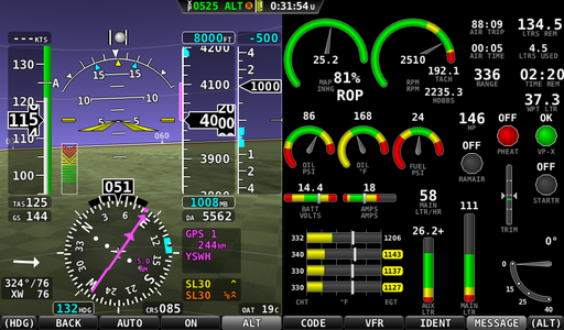

Can anyone help me program a wind-direction arrow onto my MGL EFIS screen.
My RV-9A trainer was fitted with Dynon and there was a small white arrow that show the direction of the wind according to your aircrafts nose.
I would like to have a white arrow into the top right corner of my EFIS where there is only blue background.
On the attached picture there is a white arrow near the left bottom corner of the Dynon. Something like that.
Regards
Werner
Wind Indication Arrow
- DynonWindDirectionIndicator.png (177.86 KiB) Viewed 6393 times

If you are using our default screens there is an arrow and speed indication on our larger maps (where there is space for it).
These are normal screen items so if you make a derivative of any screen or a new one from scratch you can place the wind arrow and related wind speed anywhere you like. Note that you select if the arrow should show the wind direction relative to north or relative to your aircraft's direction of flying.
If you do not see the arrow on your map (assuming standard screens) then one or more components required for calculations are missing.
For calculations you need the following:
Ground speed from GPS
Ground track from GPS
Magnetic heading from a compass - typically the SP-6.
True airspeed from indicated airspeed corrected for temperature/density.
Of the four above items if your indication is way off - it's your magnetic heading. Make sure you have located and calibrated your compass properly or else this cannot work.
There is also a quite useful display in the diagnostics menu which shows you what is going into the formula and what comes out. It's the standard wind triangle stuff you were told about in ground school.
