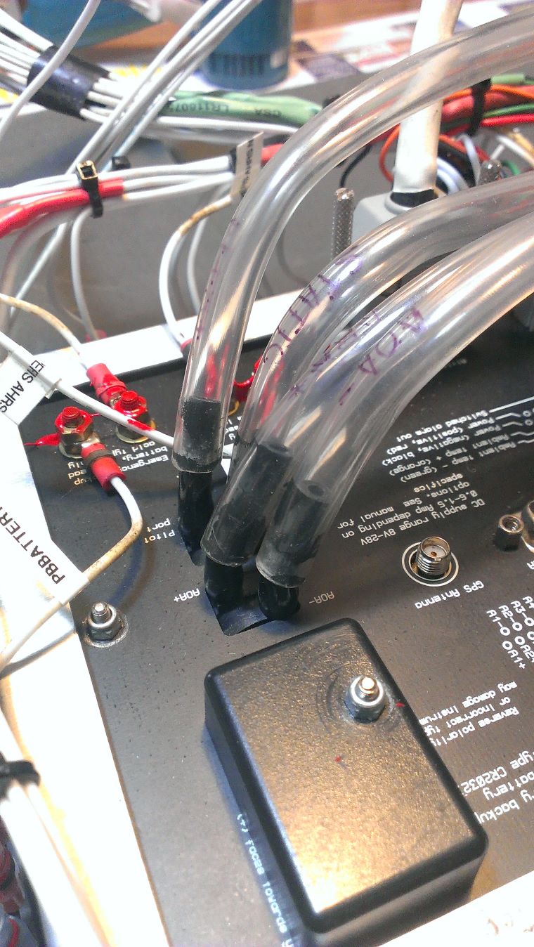

I am seeking any ideas in what type of air tube I should use to renew the tubes behind my panel and two Voyager EFIS's.
The current PVC tubes have got a little hard with age and having two Voyager EFIS's there is double the number of tubes to route behind the instrument panel with the older bard tee's to split the air tubes going between the EFIS's. I also have to remove the tubes from the EFIS's sensor bards to get each EFIS out of my panel, once the panel is removed from my aircraft.
I would like to redesigned this so there is a fly tube that stays on the EFIS and using push on tube connect on the fly tubes.
The pic is how my air tubes are currently attached to my EFIS's and how they did it some years 13 years ago. The PVC tubes have shrunk a little in length and so its getting harder to move the tubes around without putting further strain on the sensor bards.
Air Attachment Tubes EFISV2.jpg (188.62 KiB) Viewed 14311 times
