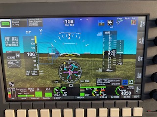

I have another problem, very often the automatic pilot fly the plane next to the path.
you can see on this photo that my position is to the right of the trajectory… why could it be?
