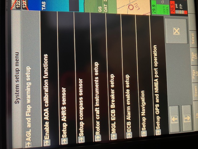

Here are some step by step instruction that should help.
Select MENU
Then select SYSTEM SETUP MENU, Go to the second page and you should see this:
Select ENABLE AOA CALIBRATION and the screen should disappear and return to your main screen
Press MENU and go to the second page and you should see this:
While in flight you will select each of the 3 calibration functions when you reach their appropriate speeds
Glenn Davis
