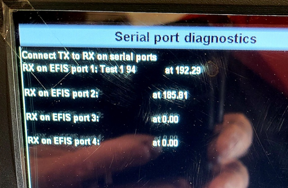

To answer my own question, for the benefit of others, here is how the test mode works. I discovered another MGL owner on the airfield who showed this to me. I suppose MGL has documented this but I don't know where.
Just connect a jumper from Tx to Rx and switch to the 'Serial Port Diagnostics Page'. You can see in the image below that port one is test mode. The "94" you see will be counting up if it is working.
In my case, I was trying to trouble shoot the RS232 between the MX1 (port 4) and iEFIS Extender (port 1). For this test , the connector from the Extender was removed the jumper placed there. This way both the RS232 port and wire harness were tested at the same time. Upon doing this it was very easy to see that the wire and pins were correct and that the RS232 port was active (port 4 in this case). That narrowed down the problem to two possibilities either a bad Extender (which had already tested good) or the pins were reversed.
Although I had carefully checked (ringed out) the connections and checked the pins etc on more than four occasions, on more than one day I went ahead and swapped two pins. Bingo! the Extender now worked. I've not yet confirmed it but it's my suspicion that either the MX1 or the Extender's pins are marked incorrectly. From what I can tell, according to the diagram markings, I'm now wired RS232 port 4 to Extender port 1 as Rx->Rx and Tx->Tx which should not work.
So I've purchased a small cheap ($74) oscilloscope and the next time the MX1 is out of the plane I plane to check to see which pin is actually the Tx pin. If the Rx pin is transmitting then MGL you owe me lunch for two weeks of lost time trying to track this down.
