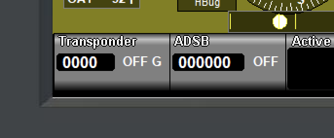

I'm a bit confused about the [ADSB] tool on the default MX1 screen below.
Screen Shot 2021-02-22 at 8.27.00 PM.png (18.81 KiB) Viewed 7528 times
I'm not quite sure what this is for as it seems the Transponder tool (when configured to slave) does everything that is needed. Can someone explain this?

This is the control for a transponder and a separate ADSB transceiver. You can slave the two - to make sure they always transmit the same squawk.
If you only have a mode-s transponder you can ignore the ADSB - no functionality here - if you have an ADSB UAT receiver you do not need the ADSB control either.

Thanks Rainier, So let me restate this to be sure I have it clear. Although I installed it I don't always understand the ADSB hardware. I have ADSB-out with the TT22+SP12, so the xpnder and and ADSB out device is one in the same. Thus I don't need the ADSB 'tool'. Also, since I am using the Stratux to receive UAT, I dont need the ADSB control. I'll go ahead and slave the two but I'm not sure that will be doing anything though doesn't seem like it can hurt.
Great, now I can remove that control from hogging screen space.

You have 1090ES. It is often referred to as ADS-B but that has caused a lot of confusion with 978Mhz UAT which is the actual ADS-B system.
The information your transponder broadcasts on 1090 Mhz is very similar but not identical to that of the UAT transmissions originating from a ADS-B transceiver.
ADS-B ground stations receive both UAT as well as your 1090ES transmissions and merge this information into the network. That is why your transponder is ADS-B compliant.
As far as the EFIS goes - if you edit your own screens - you can remove that ADS-B control interface as you do not need it - everything happens via your transponder and you don't have to worry about anything.
