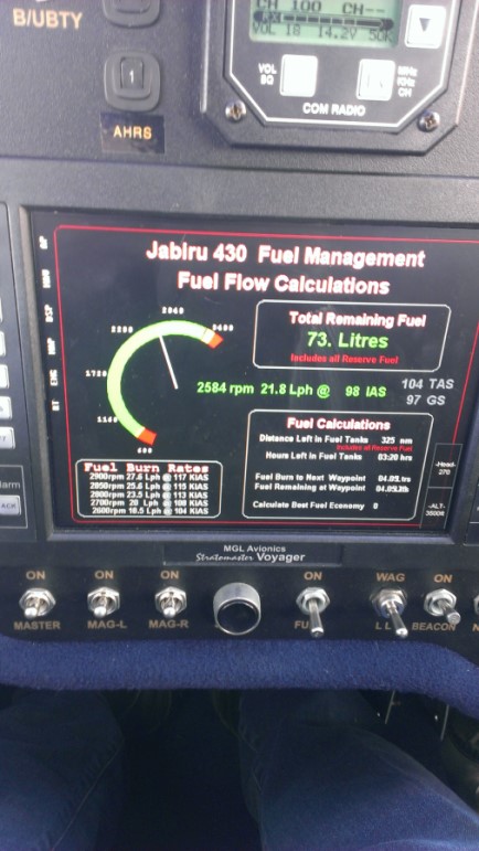

Here is a pic of a screen I did up, it's since been tidy up a bit more, but gives you and idea of what you can do with an MGL EFIS.
Fuel Burn ScreenV2.jpg (84.07 KiB) Viewed 2637 times

Thats a cool looking screen for fuel flow! I bet that took some time to design.
