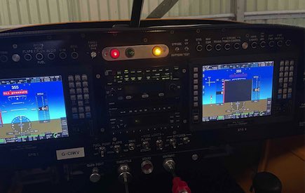

This is a photo of a friends MGL Screen after boot up. The empty black box appears on the right screen (page 1) after each boot and we are unable to clear it. This screen is slaved off the left screen however I dont think that has anything to do with it. No other screen pages have the black box.
Any ideas greatly appreciated.

That's a video input window.
The left or right curson buttons will scroll through video sources to none.
Stuart

That was quick and thank you very much. I will pass on the information.
