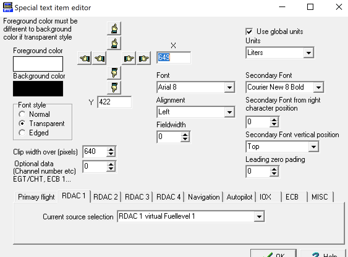

jwaldrip wrote: Tue Nov 23, 2021 1:50 am so are you saying I need to set up a virtual tank in the screen designer? If so can't do it. I don't think I have any real-estate left for another tank.
You could leave out the 'tape' and just use the number of gallons remaining like...
Screen Shot 2021-11-24 at 6.26.55 PM.png (45.61 KiB) Viewed 3385 times
If you really want to impress your friends you could make a touch area to bring up an 'info' screen and you could then have an expanded fuel page on that info page. Touch it again to make it hide.
