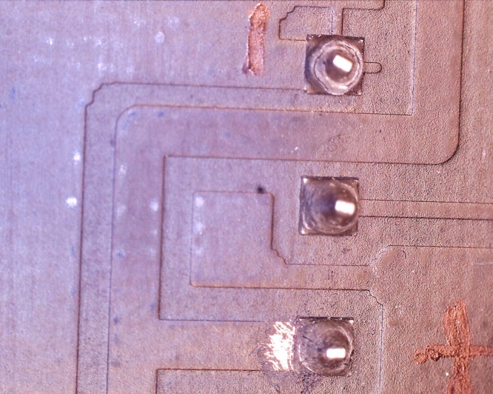

The other day, I turned the Pilot EFIS on and saw no readings for any of the sensors that are wired to the RDAC, but then after turning on the passenger EFIS which share the same RDAC, all the Pilot EFIS RDAC sensors came to life.
The first pic is of the 3 pins on the inside of the EFIS's rear panel that come through from the RDAC screw block, 2 pins supply the power to the RDAC and the middle pin is the signal from the RDAC. You may see the problem straight away and I think the bottom pin has the same thing happening.
EFIS RDAC Connector Solder PinsV2.jpg (225.59 KiB) Viewed 2770 times
This pic tells the story once you move the RDAC screw block a bit, so a quick solder of all 3 pins should make them good for quite a few years.
Rear EFIS RDAC Connector, Neg Power PinV2.jpg (200.58 KiB) Viewed 2770 times

My guess is "work hardening" - the connector is vibrating and this ends at the solder joint. Eventually the point of highest flex on the solder hardens and eventually cracks. Yes a reflow of the solder (with a touch of flux) renews the joint. Try supporting the connector or wires to the connector to prevent another occurance.

I did not realize that solder get so brittle from vibration, but it certainly seems crystalized from this microscope picture.
My wires running to the EFIS were not that well supported when I removed my instrument panel for the first time, but they are much better supported now.
So I guess the take away lesson from this, take the time to make sure your avionics cables are supported as much as you can.
I think this pin finally cracked out after I tightened the RADC cables back into the connector this last time.
