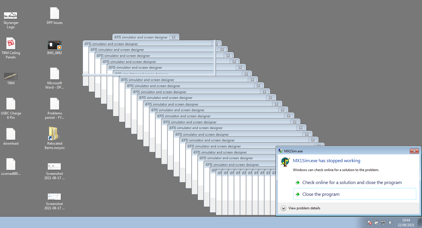

Looking at customising the setup in the IEFIS simulator, I find that the same happens with some projects when simulating. Also, after loading different projects, the app starts giving 'invalid filename' errors and when you close it, hundreds of repeated error messages stack up (see attached).

The above image looks like the application is not able to access its files. Can you make sure it ts running with administrator privileges - alternatively install it outside of the "program files" folder (just create a new folder under your C:\\ root and install there) then regardless of security settings Windows should allow it access to its own files.

Will try moving the app installation to afolder in the root directory. I get the same issue under Win7 and an old XP machine with admin logon so hopefully moving the app will work?
