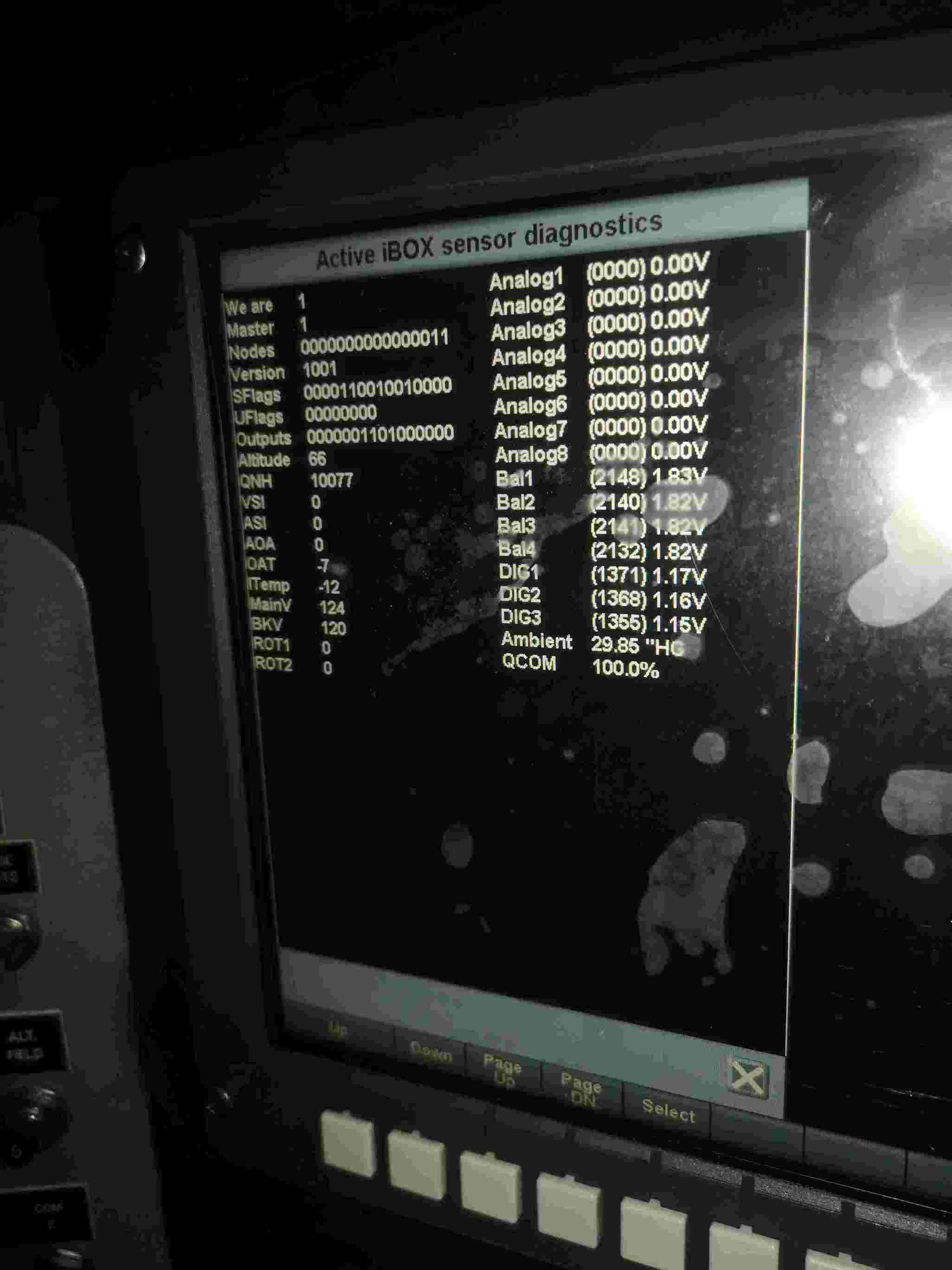

I check the Version of the software in the IBOX and it read ''Version 1001'', the version that I did upload was supposed to be Version 5.
I dont see a 5 in the Version number ? What should be the number after a Version 5 upload.
Sylvain

5 in binary would be 101, now I have 1001 which is 9.
Re: GPS satellite no show.
The current fimware would report itself as 1006. The leading "1" means it is a V2 ibox.

I did instal the latest firmware for my V2 I box, I am seeing 1006 as the latest version now. I also uploded the firmware for both Chalengers screen but I still have no show for the satellite and now occasionaly the second screen stay blank when I power up the system, sometimes both screen stay blank at start up. When both screen are OK I still loose the GPS often and I have this message ''No sensor data available Check iBOX data feed''
