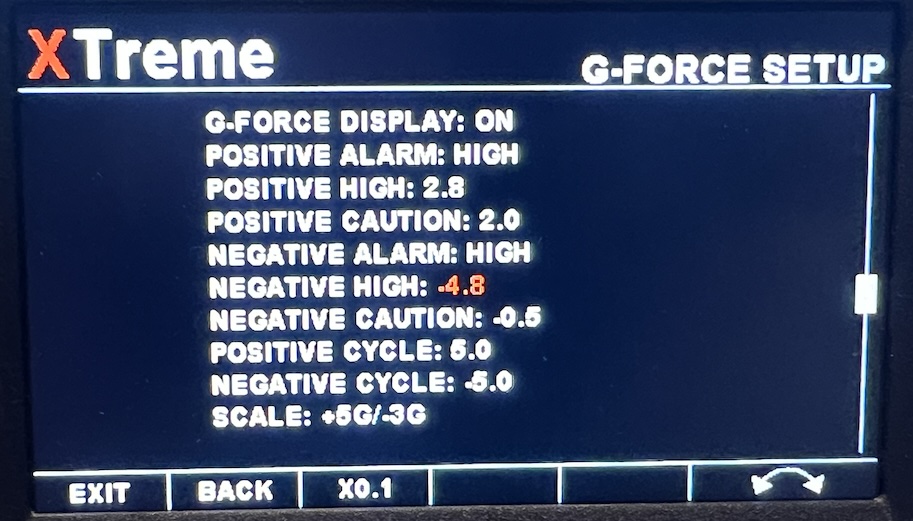

I just bough an XTreme EFIS G3 + RDAC XG.
While doing the initial setup of the XTreme, I've noticed something weird, which looks like a bug:
Among the different settings in the G-FORCE SETUP page, two items are related to the negative G-force:
- Negative Alarm, with a binary choice HIGH/CAUTION
- Negative High, which is a G force value
When pushing the rotary button, the item enters the configuration stage where its value can be change, as any other menu item.
Then, when turning the button counter-clock wise, the negative G decreases, as expected. However when turning it clock wise, the G-force value does not change: it is the previous item that is updated, that is HIGH/CAUTION.
The reverse behavior appears when the HIGH/CAUTION item is configured: CCW turn updates the item, CW turn update the negative G value.
It seems the indices of the item to update have been swapped somehow with the negative G-force menu items.
I'm using FW v.3.10. I've power cycled the EFIS 3 times with the same result to ensure this was not a transient issue.

Yes, you are correct. Thanks for bringing this to our attention. The negative Alarm/high items are swapped. We will fix this in the next day or so.
You can find the firmware revision in the MISC SETUP->INFORMATION.
