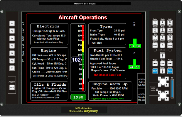

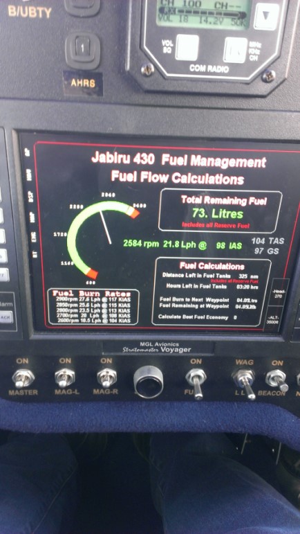

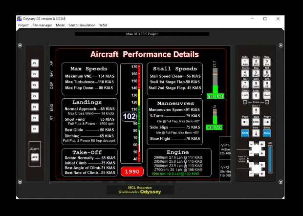

Here is the type of thing you can design with the MGL Screen Designer that you can then simply scroll backwards and forwards. These are some of my info type pages which you can scroll between by a button press. You can get the idea of what you can do to have a simply one button push scroll using the page - or page + buttons to scroll between your checklists pages. To be honest just about anything you may want your MGL EFIS to do, it will more than likely with some screen design time, be able to do it for you.
JimJab.
