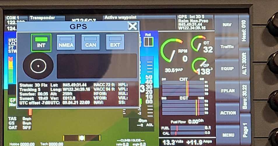

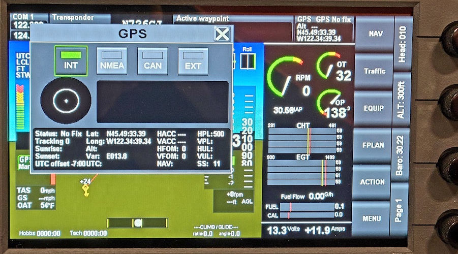

Since firmware 10 my satellite map has been blank. Both pics.
Upon installation of firmware 11 the GPS stopped getting locations altogether. But then yesterday I rebooted holding the knob to reinstall the firmware already on the mini-sd card. After that the GPS started working immediately but there still is no GPS satellite map.
Does anyone know a fix for this?

- No Fix - No Map
- MX1_NoGPSfix.jpg (210.43 KiB) Viewed 3052 times
- Yes Fix - Still no Map
- MX1_No-Sat-map.jpg (182.5 KiB) Viewed 3052 times

Re: MX1 GPS satellite map
Rainier, I'll check this out later today.
However, I'm not sure that we are talking about the same thing. The actual 'maps' work fine. What I am calling 'satellite map' is the inset picture, above, that normally show which GPS satellites are visible at the time in the round circle (based upon time and location) and what GPS satellites are actually 'seen' (in the rectangle box to the right of the round circle).
For example: The second picture, above, shows "Tracking 5". In such case there should be at least 5 satellites and their signal strengths in the rectangular box.
Thanks.
