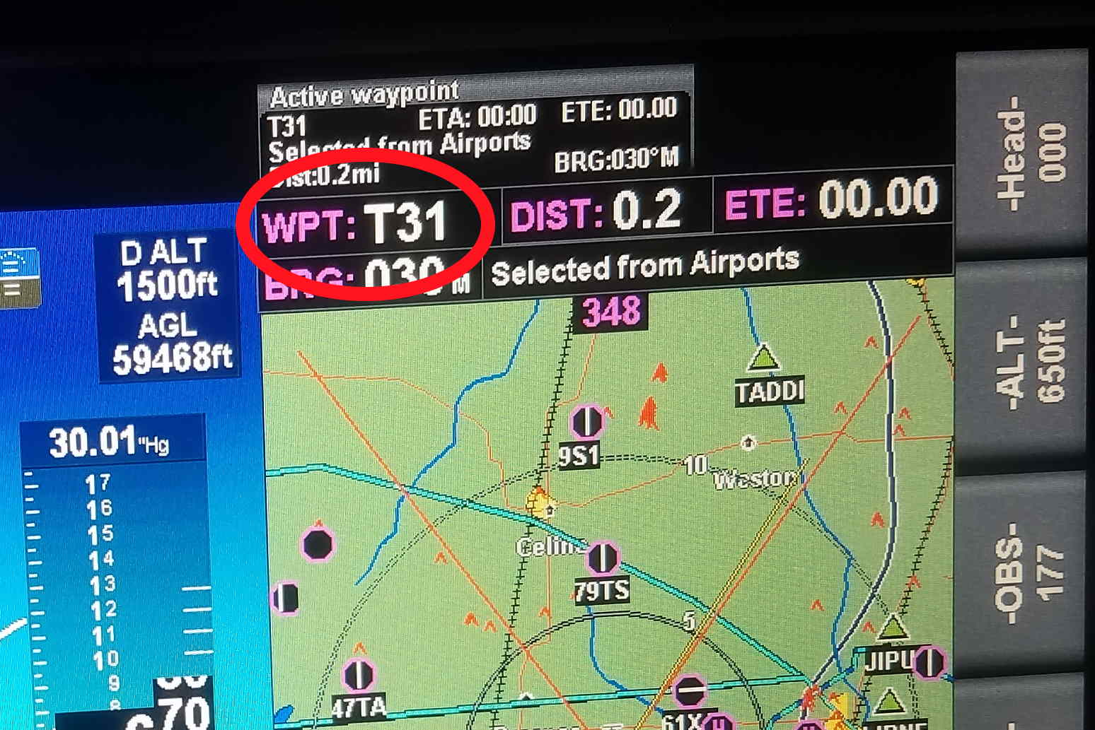

tdyer wrote: ↑Sat Sep 05, 2020 9:24 pm I have a challenger that has a couple items that do not work the same way the simulator does.
1. The simulator retains the last waypoint when you shut down the simulator. My challenger looses the waypoint if it is power cycled. I there a way to make it retain the last waypoint after a power cycle?
I double checked the keep alive pin and it has battery voltage on all the time. I also replaced the battery just to verify that that wasn't the problem. The old battery measured 3.3v. The attached photo shows the wpt value that disappears after a power cycle. I am sure the battery is not the problem because the tach, hobbs, and maintenance timers have not been erased. I also loose the "Show D and E airspace" settings about half the time.
tdyer wrote: ↑Sat Sep 05, 2020 9:24 pm 2. If I select an airport on the screen then hit the airport info button the simulator has a "GOTO Airport" Button that will set the touched airport as the waypoint. The efis has a goto nearest button that does not seem to do anything when pressed. Is there a way to edit the airport info menu? Do I have a different screen installed in the efis?
It looks like the problem is that the efis locks up for about 20 seconds when the Goto nearest button is pressed, then it comes up with a blank menu.
There is no way to send a preset value to the virtual tank instead of popping up the keypad to enter it.
Thanks for your help
