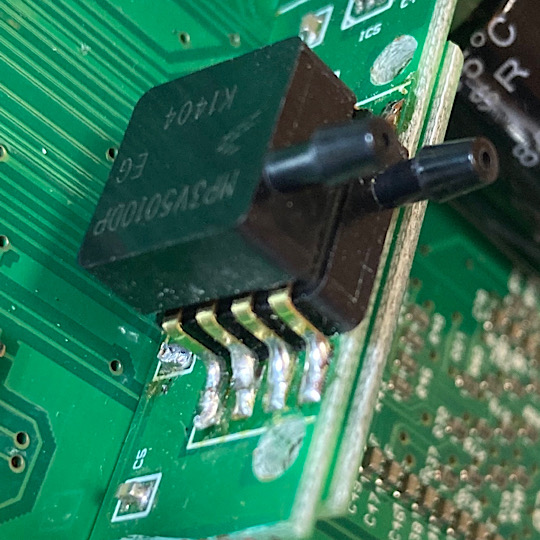

Hi Leewwalton, I am curious what the resolution has been to the ASI readout problem you experienced. I have similar on an Explorer iEFIS Lite, the readout eventually stuck at 44kts (since been relying on my analog ASI). As mentioned, I reset the EFIS ASI to zero, where it remains stuck. Tried gentle Pitot port pressure, still zero. Before removing my EFIS and despatching it for repair, what happened in your case, I wonder? Thanks John

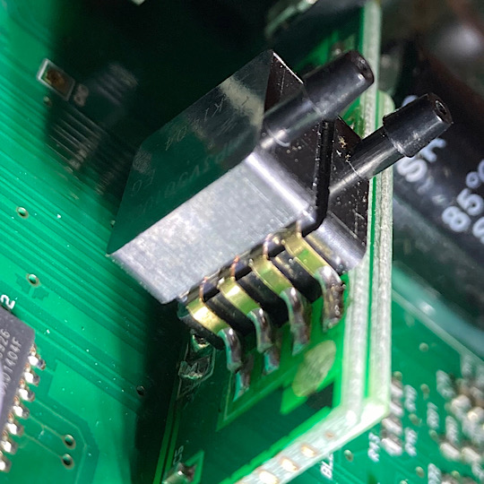

If the reset ASI to zero makes no difference the ASI sensor has most likely been lifted off its pads on the rear PCB. This can happen if a bit of force is used to press on the hose fittings. Newer devices have added strengthening here.
The ASI sensor is soldered onto 8 pads on the PCB, only three have electrical connections. The bottom of the sensor has a small hole and the PCB has a cutout underneath - this has a rubber 0-ring as seal and then there is another PCB fitted that contains another sensor - your altimeter. The bottom nipple of the ASI sensor is connected to the altimeter sensor via the hole (so that is the static pressure).
If you remove the rear panel you should be able to see immediately if the sensor has lifted. if yes it is simple to solder it back. It may be possible that the solder joint(s) were strong enough causing the entire pad(s) to separate from the PCB. In this case use a small amount of contact adhesive to glue the pads back (a very small amount - use a tooth pick). Then remove a little bit of solder resist (the green stuff) off the three tracks (if all three are broken) that connect to the sensor and solder small wires to repair the connection or usually you can just bridge the gap where the track broke with solder.
Once done, do the ASI zero again and you should be back in business.

Hi Rainier, re-soldered the connectors (sprung loose by the factory fitted cable tie), installed latest software, zeroised ASI sensor, and success, have fully functioning unit again. Thanks again, John
