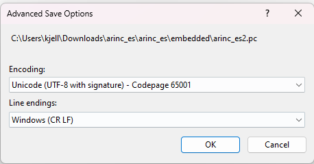

I solved the problem with the ARINC-424 text file.
Opened it into Visual Studio and resaved it according to the following encoding:
Imported it into MGL-Central as an ARINC-424
Skärmbild 2023-10-16 205441.png (69.55 KiB) Viewed 13922 times
Exported the Navidata file and installed it in the Simulator through the MMC (SD-Card)

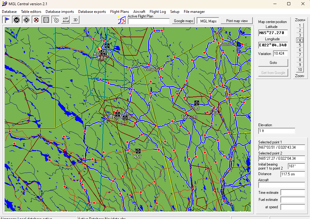

What do I need to do to have the underlying map as in your picture?

ARINC file is not a map. A ARINC424 file contains navigational data.
For maps from OpenFlightMaps use MapMaker2 with the EPGS53857 format mapsource (described in the included pdf file after installation).
