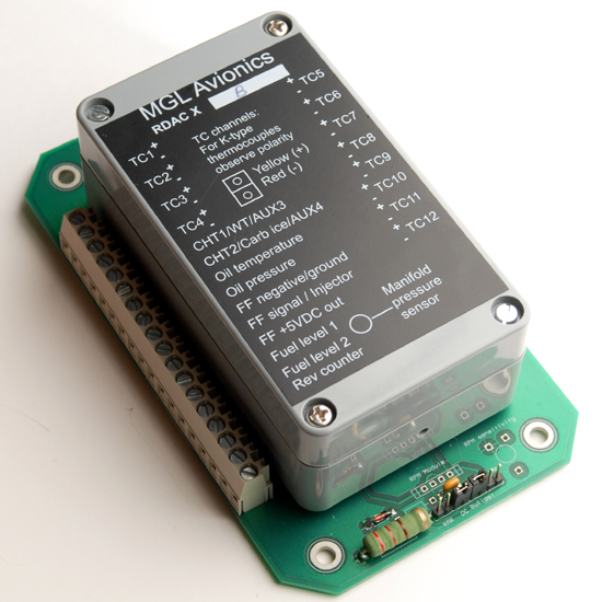

I received RDAC X-B as a gift.
But for some reason the equipment is different from those that I find in the photo on the Internet.
It's as if there is no interface board.

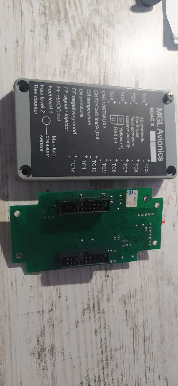

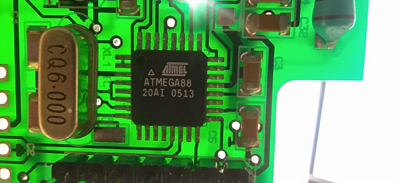

I disassembled the case, powered the LDO(L7805) with 9 volts and do not receive any data via the RS-232 protocol

The problem is that the LED does not light up and does not blink at all.
Although +5V power is supplied to the board and the MCU.
Perhaps the microcontroller has become unusable, but I can replace it, but I couldn’t find the firmware anywhere.
I can write my own code for MCU, but all the functions of the device will not be implemented as intended.

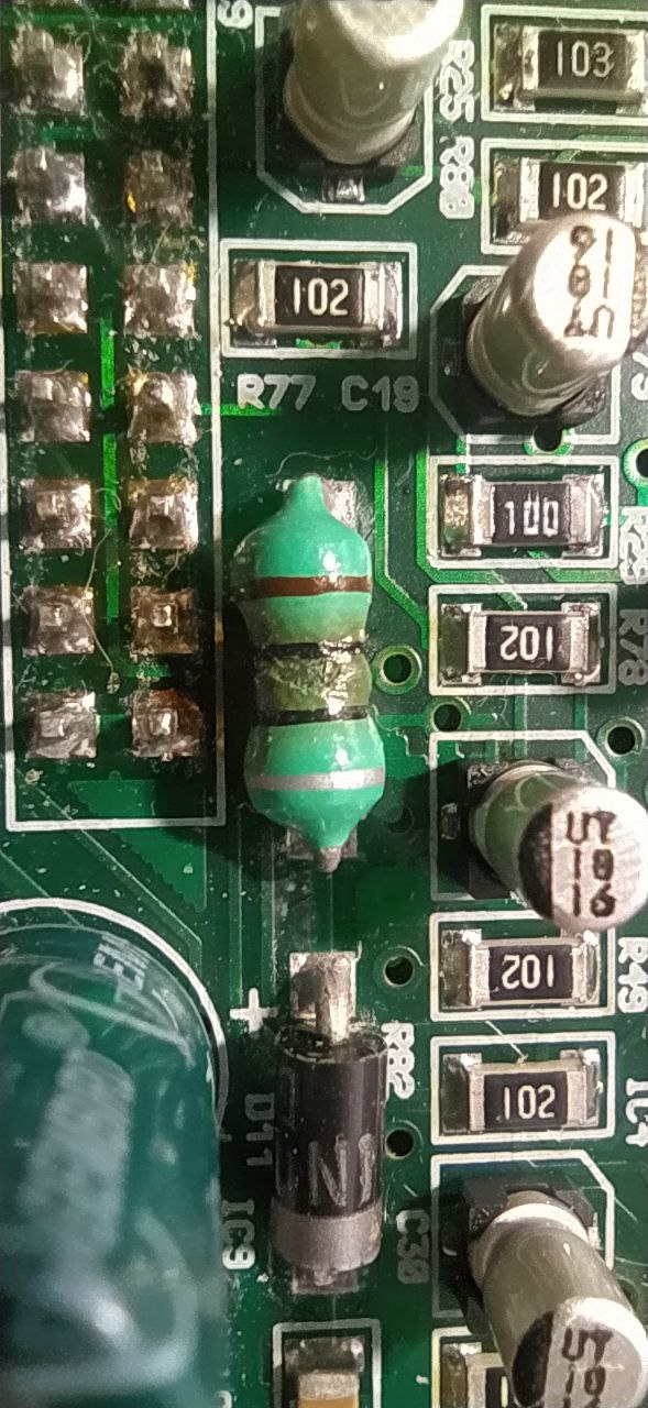

I also discovered that the inductor was burning, but overall it is still working.

But, as I wrote above, it feels like the bottom board, on which there were connectors and contacts for connecting sensors, has disappeared.

The LED will flash at 1Hz when the CPU is running.
If you have supply voltage at the CPU, the reset line is logical high, I'd be pretty sure that CPU is history - if you can find a replacement (make sure it is exactly the same) contact me privately and I'll send you the binary to flash to the CPU. You will also have to do some calibration and I'll tell you how to do that. You will need a 24.9mV DC supply for that (low impedance or a resistive divider and multimeter to confirm correct voltage).

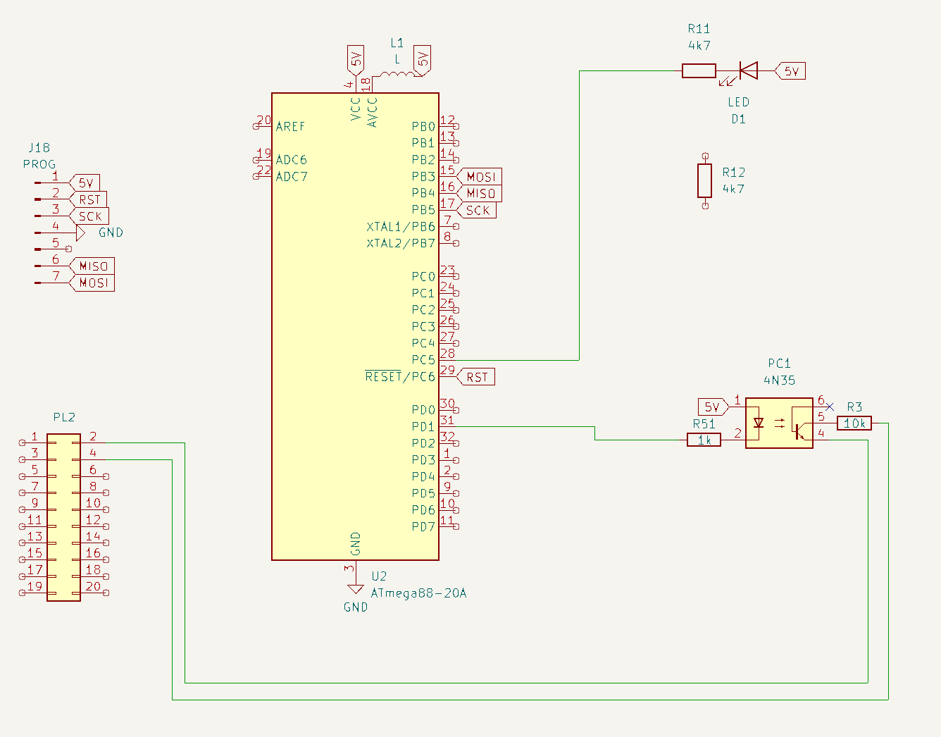

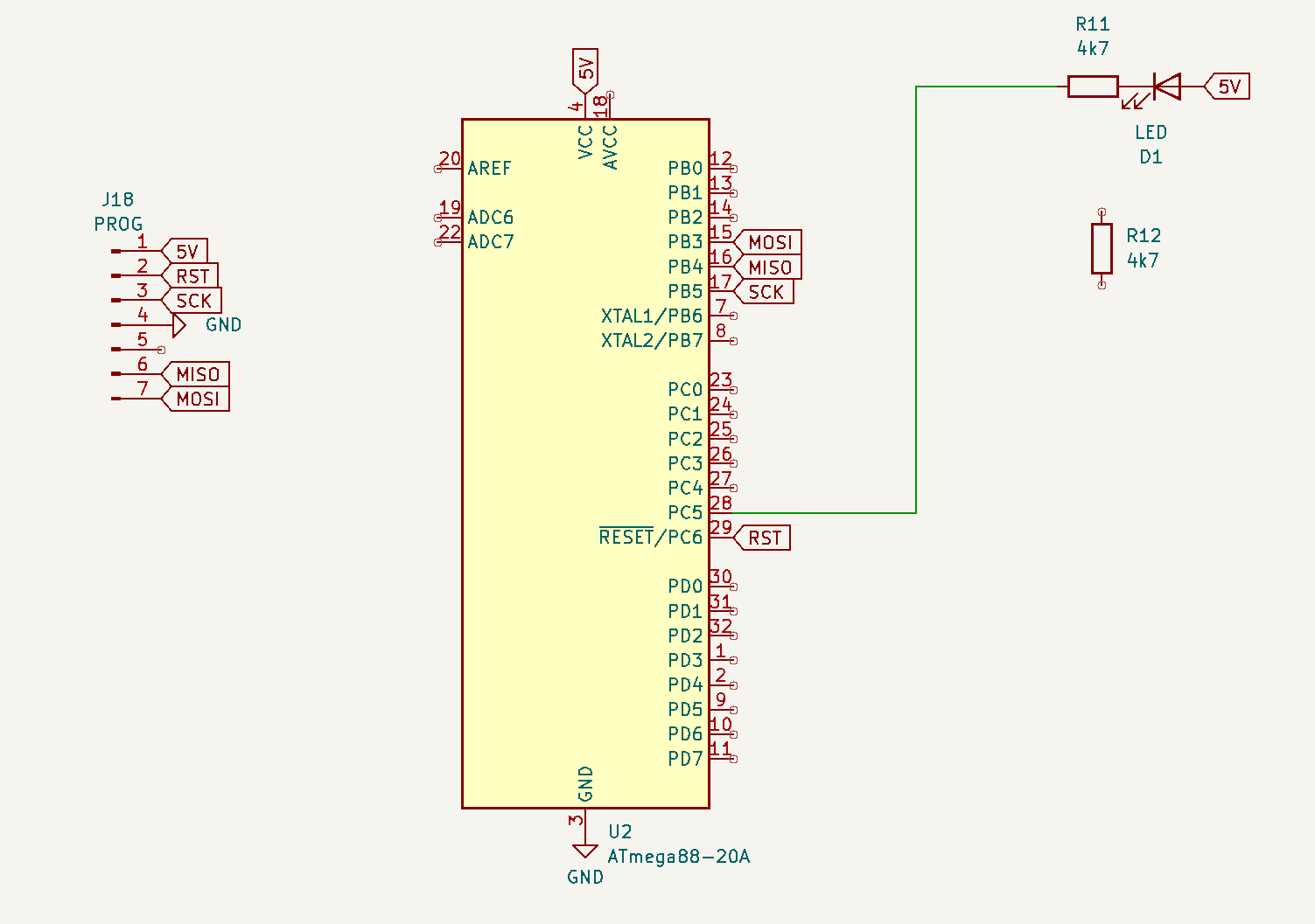

On the pin of the PC6/RESET microcontroller there is 4.5 volts, which corresponds to logical 1.
Below is a diagram that I was able to draw from the board.
I still think this microcontroller(ATmega88-20A) is fine
but I also bought a similar replacement, if there is firmware, I can download it.
As far as I understand, from the output of PD1 (TXD), the data received by the microcontroller and converted into the MGL protocol is supplied in UART format to an optotransistor, and data can be obtained from the PL2 connector.
